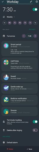

I don’t understand why this sometimes wakes me up abruptly with the full volume angry alarm early in the morning. I am always too sleepy to figure out what’s going on and forget to check into it, but I captured a screenshot this morning when it happened:
Jello @o12345,
the alarm has 30-minute smart period, so at 7:21, it could have been in progress for 21 minutes (if the smart alarm was triggered really early).
If you had the selected ringtone, but very loud, the gentle volume increase could have been already at 90-95% of the volume.
If you heard a basic sirene ringtone, the backup alarm (full volume alarm) was already triggered after 20 minutes. The backup alarm is triggered if you do not react to your alarm for more than 20 minutes.
If you need more time to wake up, prolong the alarm time out in Settings > Alarms > Alarm time-out.
Or, try another ringtone if the gentle water sound does not wake you up even at a loud level.
What triggers the smart alarm? Shouldn’t the backup alarm wait until the end of the “smart” period? This morning the gentle alarm was still going at 7:30 am as I would expect.
The smart alarm is triggered when a light sleep phase is detected.
The alarm time-out has no connection to the smart period, it is triggered after 20 minutes after the alarm start. You can configure a different alarm time-out period if needed.
