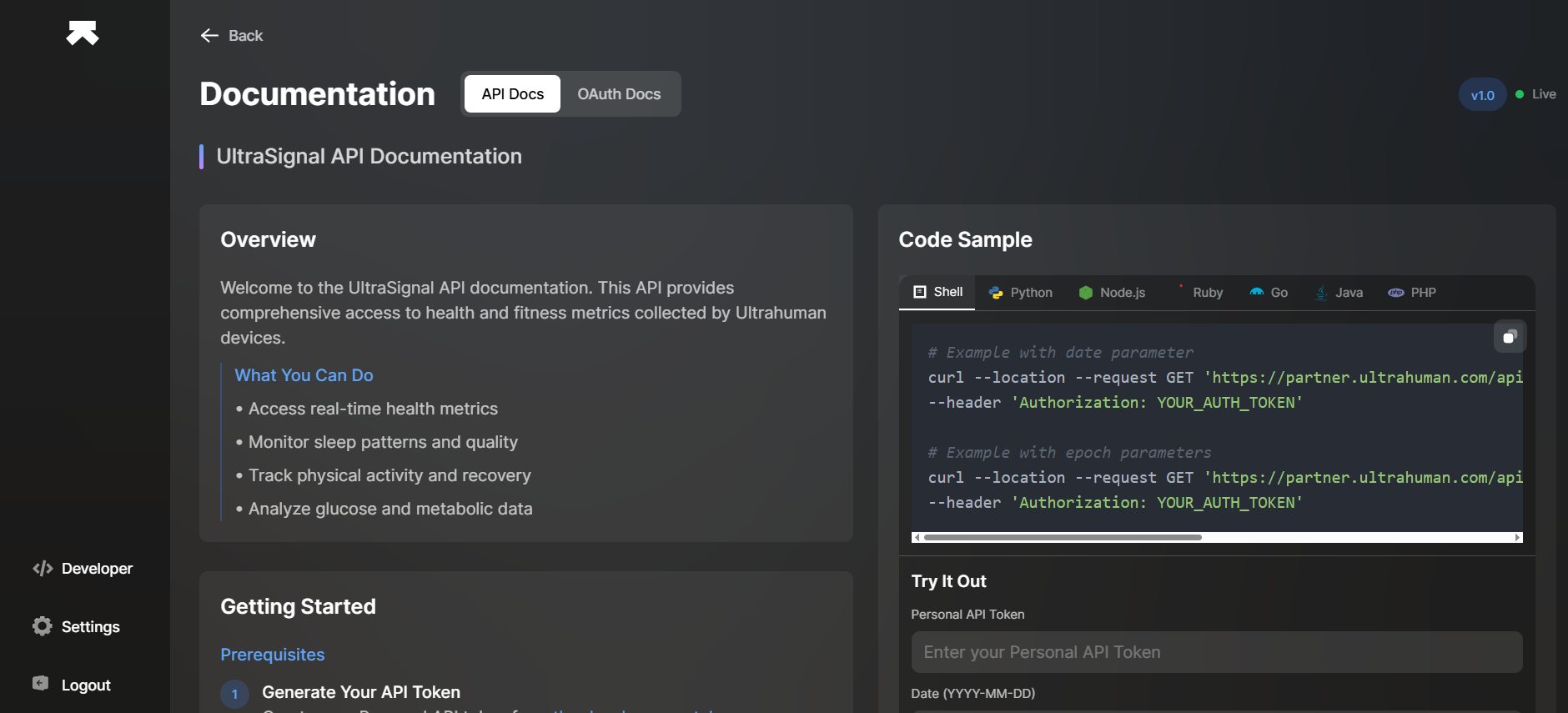

There exists a complete API to access real-time data (see attached screenshot). User data is available only after authentication, which I consider correct. And definitely it isn’t paid. Could you please look at it?
Hi @petr, could you please send a link to the documentation?
And does it mean the data access is meant only for individual users, or it is a full public-facing API for developers?
How long has it been published and maintained?
Sometimes the API is only for individual access (and it is not paid because you pay for it by purchasing the device), while the access for devs is paid as a form of partnership.

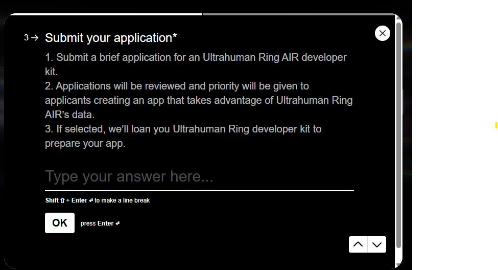

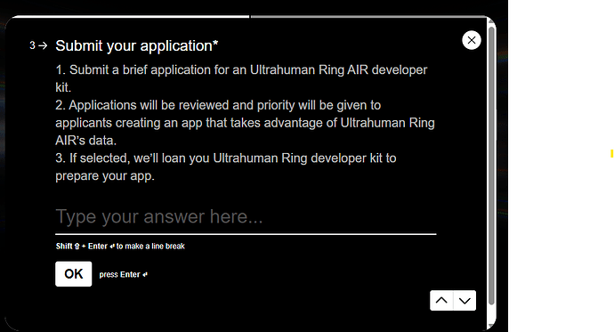

the screenshot is from my account. But it seems, that you can create developer account at Introducing UltraSignal: Ultrahuman Ring Air's developer platform. and get even something called developer kit (see attached screenshot from step 3 of registration. I didn’t continue further.)
So, there exists support for developers of third-party apps.
Hi, the expression “we’ll loan you developer kit” + the fact the documentation is not available (unless you commit and sign in) does not feel like a public-facing API with free access… but we will check it out. Let’s hope for the best.
Hi, it will be great. I suppose that the developer kit contains a debugging version of the ring, so I understand that it is not available to all, but only to serious developers. As you said, let’s hope for the best.
We applied, so we should be on the waiting list.
