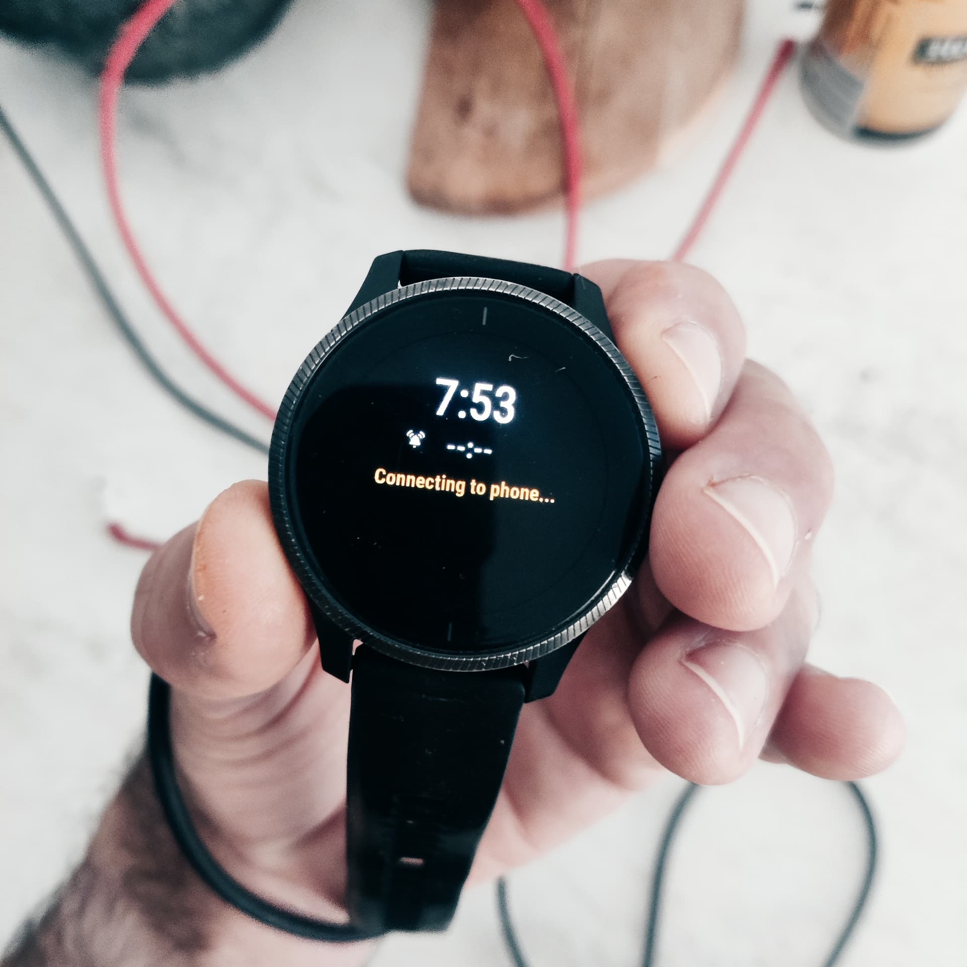

I can’t seem to connect my Venu anymore. After initializing sleep analyse on my phone the launch sleep prompt gets initiated on my watch. After confirming the watch keeps displaying it’s connecting to phone. The phone displays a warning that the alarm clock and sleep analyse probably is not working on my device. I’ve turned off battery optimization by setting 'app battery usage" on unrestricted. But that doesn’t resolve the issue.

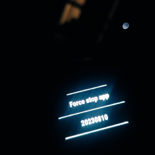

Weird thing is that in connect IQ the version number is 20250804 and after a second reinstall my watch displays 20230810

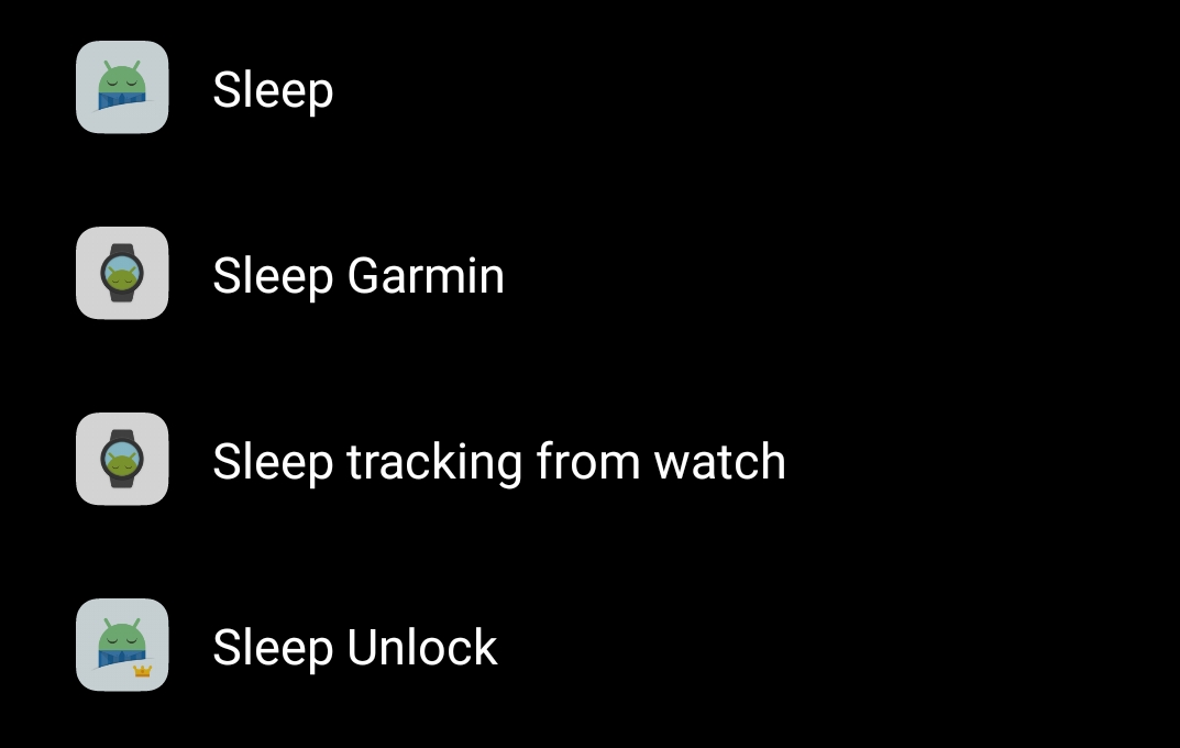

Hi, the addon from the phone must be uninstalled (not reinstalled).

Is the addon on phone uninstalled? From your screenshot it looks like it is still present.
I thought you meant the add-on on my Watch. I’ve un installed everything from my phone and Watch. And installed everything again according to the manual. Followed all instructions from “Don’t kill my app” and even switched to developer mode to lift BT restrictions. (they are hidden) In gave all apps all the rights I could find and it’s still not working.

If I start from the Watch it opens the tracking screen on my phone. The watch stays in the connecting to phone screen as in the picture I uploaded earlier.
I can also stop the analysis on my phone from my watch
It sounds like the phone sees the watch, but does not let us to communicate with the addon on the watch.
