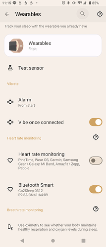

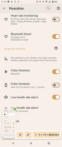

But the setup should be:
Settings > Sleep tracking > Wearables > Wearable > FitBit - for movement
Settings > Sleep tracking > Wearables > Smart BT - for Go2Sleep device HR
Settings > Sleep tracking > Wearables > Pulse Oximeter (Bluetooth) - for SpO2 data from G2S

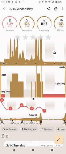

I tried it.
1). HR seems to have been obtained(I don’t know the source, Fitbit or Go2Sleep).
2). SpO2 could not be obtained.
3). Data acquisition is interrupted.
Please tell me.

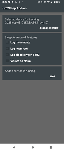

1). Do you use the Go2Sleep addon?
2). How can I get my sleep data completely? I want to eliminate unused time.
3). I send setting image, this setting is OK?
Using device is SONY Xperia(SO-51B).
Hi, looks like the addon did not send any SpO2 data.
And both devices disconnected, so maybe BT was interrupted?
Sleep app seems to be running (the sound is monitored).
Could you please use the Left ≡ menu → (?) Support → Report a bug? I don’t have enough info just from the screenshots.

Good morning.
This morning checked data, some time data missing and SpO2 could not be obtained.
I just sent you a report about the log, so please check it.
