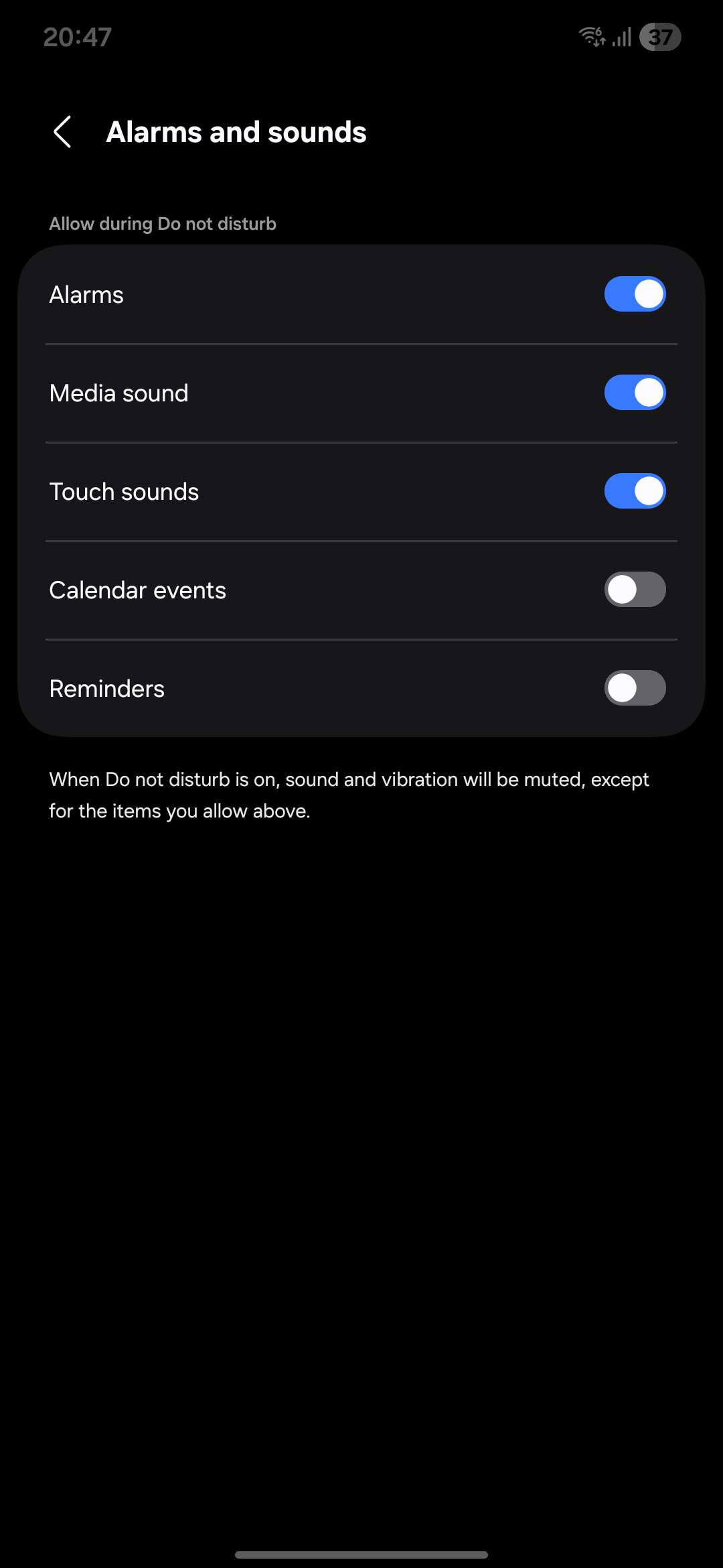

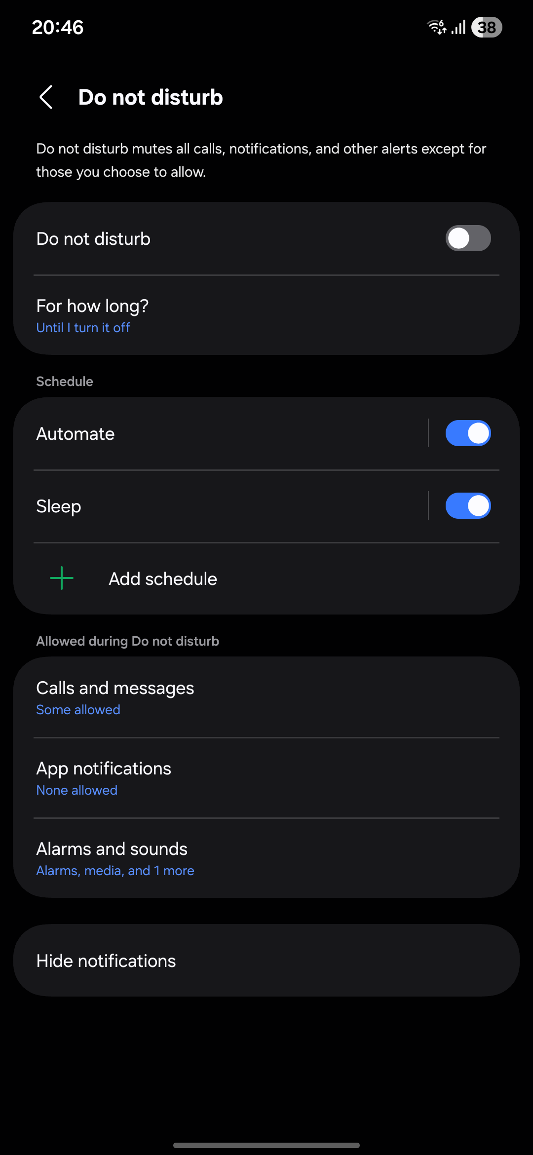

Where is this Priority mode? My DND settings look like this:
Hi, sorry, I misunderstood the main developer.
The TTS is blocked when DND mode is higher than priority (so no exceptions).
We are testing an experiment with the TTS blocked even for the priority mode.
