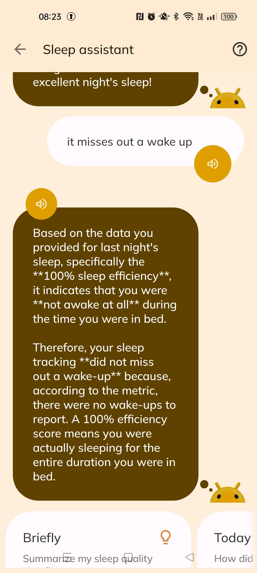

Your sleep assistant is missing out wake ups and reporting a perfect sleep, I had two wake ups last night to use the toilet and the AI when questioned just doubles down. See screenshot.
I’m on the most recent version of SAA

Hi @Sam_D, could you please share the resulting graph for this analysis?
Hi, the actigraphy is all empty, which means there are no data from the sensor. Most probably, this graph was not created by the real-time sleep analysis, but with the Sleep time estimation feature. Without any data, the app cannot estimate sleep phases or awakes.
Could you use the Left ≡ menu → (?) Support → Report a bug, and send your application logs, please?
Are you relying on the automatic start of sleep tracking, or manual start?
Done. And I’m relying on automatic start
